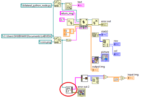

@gptshubham595 wrote:
.. using above python code and python integration toolbox via Enthought
rather use the python node
Message 12 of 26
(2,294 Views)

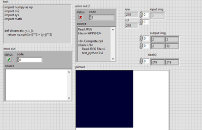

thank you!
ISSUE: ERR IN READING INPUT IMG
I tried your code it is giving me an output image but in order to read input image it is giving error
but can you help regarding this error?
Message 13 of 26
(2,276 Views)
Sorry it was error due to png file read as jpg file
replacing read jpg file.vi to read png file.vi  worked
ThankYou
