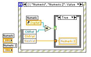

If you want to have 2 controls which can be changed and affect each other at the same time (similar to a slide and its digital display), you can do something like this:

You cannot have two FP items for the same control, but you can make two similar controls that synchronize their values and feed into the same logic. Use tst's code above for example.
If you want to really create a programmers nightmare, move the single control around between two different location on the FP using property nodes depending on the boolean state.
If the FP is already really big, it seems foolish to make it even bigger by duplicating controls. Maybe you should change the layout so the control is convenient for both states. 🙂

Altenbach very nice use of a custom control and digital display. Although, it leads us back to the same question:
Aurelia, what exactly are you loooking for, and is there a reason you want 2 differnt controls to act and behave identically?
Can you attach your VI so that we can look at the Front Panel and see the controls you are trying to duplicate? With a better understanding of your question we may be able to give you the best answer, currently we are just shooting in the dark. Altenbach's solution is great, however it only works for certain controls, what type of control are you trying to duplicate?
