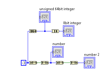

Flatten floating point on FPGA for multichannel DMA
Flatten to boolean array (free on FPGA) and then re-cast to U64 (Again essentially free if the number of bits actually match).  On the receiving end, perform the opposite and bob's your uncle.

Intaris that definitely is a step in the right direction, and will take care of most of our data types, but the "number to boolean array" node apparently doesn't support floating point.

At this point we plan on converting to fixed point before converting to bit array for packing into the DMA.

I'm coming into this a little late, but just in case someone find this useful.
You can implement your own conversion to/from Single using an IP Integration Node. I have attached the code to do this and it should work on all platforms (although you may be asked to regenerate some files). The actual VHD behind the scenes is very simple since the flattened types have the same bitwidth (I chose to use U32 as the flattened representation).

The IPIN usage looks like the following (fill in your code between the flattening and unflattening).
I've also attached a sample project for you to try out.

Intaris,
I'm finally implementing your suggestion.  I assume you aresuggesting the lower path for encode/decode because it's cheaper on FPGA?
