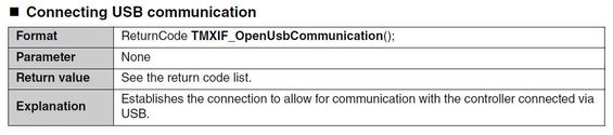

So I tried to call a simple function (Connect via USB with controller) only with return code and without parameters beeing passed.
The Format of the function for Connecting USB communication is:
ReturnCode TMXIF_OpenUsbCommunication();
My Call Library Function:
int32_t TMXIF_OpenUsbCommunication(void );
I also tried different return types, but always recieve Error 1097.
