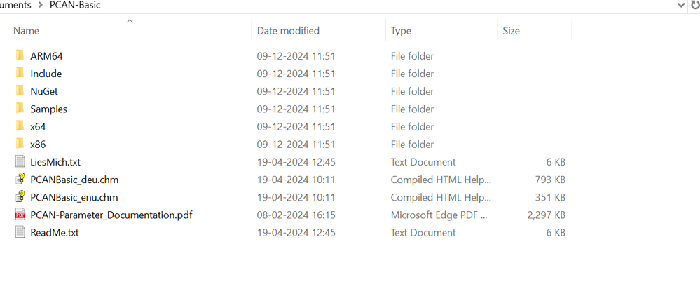

PCAN basic is free.
Also see this post about a .net version I created.
Good luck!

Yes, it is free but
how to use it in LabVIEW.
Message 8 of 31
(4,889 Views)
You need to learn usage of .NET in LV then. Refer to https://blog.dmitriev.de/labview/net/netframeworkcorestandard/
for valueable introduction into this topic.
