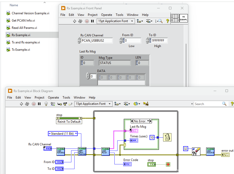

Did you even *look* at what I provided? There is an "Rx Example.vi" in <..\PEAK CAN\Examples\> folder that sounds like a very good starting point. All you need to do is decode the CAN message into the values you want.

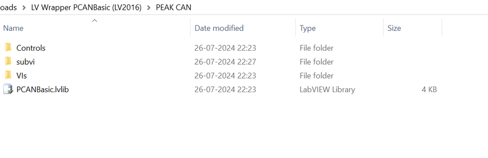

<LV Wrapper PCANBasic (LV2016).zip>
you are talking about this,
if yes then it is not containing any example folder.

Accepted by topic author Basavaraj093
Opps. Sorry about that! 🤥
See attached PEAK CAN LV wrapper *with* examples this time. 🙃
Since there is no readme in the zip, here are some notes:
- put the PCANBasic.dll (x64 or x86) into the top folder so LV can find it. (download the PCAN basic SW package)
- Requires the PCAN drivers as well. (IE download and install the drivers)
- the "PCANBasic.h" is not required for LV but it helps greatly in understanding the parameters to pass.
Drivers:  https://www.peak-system.com/Drivers.523.0.html?&L=1
SW:   https://www.peak-system.com/Development.526.0.html?&L=1
Good luck

It would be nice if you save it to lower version.
I am using LabVIEW 2018.
Thanks in advance 😊
Message 18 of 31
(3,299 Views)
Thanks in advance 😊
Here you go
