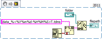

thanks for replying, please have a look at the screenshot below, I'm sorry I attached the old VI over there. Data that I have has multiple channels because of which I am using index array and the sub.jpeg part in the VI is used to generate the file name for each 1 minute file.

Hi dhananjay,
You did not attach any VI. All you show are images of code: we cannot debug images using LabVIEW!
And you didn't answer my question:
what is the filepath you are using/generating?
