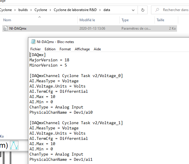

Actually, I work only on my development PC.  It is the reason that this drive me crazy...
In the data folder of the build I have the Ni-DAQmx.txt file.
Jean-Marc
(3,282 Views)
You need to make sure MAX is installed on the PC where you are having problems.  It looks like you don't have any tasks created there.
