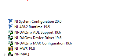

I am not sure why this happened. I was not making any changes to the LabVIEW or DAQmx environments. When I pulled up a project that I have been working on every day for a month and tried to open a vi, the Daqmx items in the project (x16) are not found. The DAQmx icons are not appearing for the block diagram either. I saw that installing in the wrong order is a problem so I uninstalled DAQmx and reinstalled. That did not change anything. the DAQmx items are showing in MAX, it just seems like somehow my DAQ stuff isn't linked properly to the LV2019 stuff. Any guidance is welcome, Thanks!

In NIPM, make sure the "NI-DAQmx Support for LabVIEW" is installed for the version you are using, including 32-bit vs 64-bit.  You will need to make sure the "Products Only" is unchecked in order to see this package.

OK. I reinstalled DAQmx and now have all of the support files. Including the one for 2019. However, When I open my main vi I still get this. Every one of the DAQmx functions is still missing. Do i need to load something? Is there a specific ;location where DAQmx should reside in relation to my LabVIEW? I assumed that would take care of itself though.
I get this.
Which is a result of this ALL OVER THE PLACE.

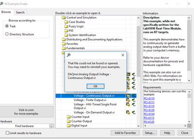

If you load a blank VI and try to drop DAQmx subVI's, or load a DAQmx example from the Example Finder, do either of those work?

Examples for hardware In and Out says this:
The Vis were written by me. They are not hard coded to a place, they go to "vi.lib" They vary from VI to VI but for the most part they are digital reads and writes as well as relay switches for routing signals. They have worked fine for months. Also, this phenomenon occurs on all of the projects and programs I have tried.
It appears that I have a weird file structure within my National Instruments folder. There is a folder for Version 2019 embedded in the 2013 folder and that is where the DAQmx has been installed. I am going to try uninstall, reinstall with a different version of DAQmx and see if it steers to the right place.

I found where the DAQmx was installed and dragged the folder to the proper vi.lib. Everything seems fine now. I am going to investigate this wacky file structure on Monday to find out what happened. Thanks again for helping.
