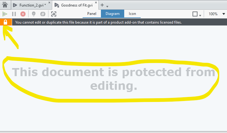

Thank you very much for your discussion.
The solution is very simple: you can create an installer and the user cannot see the diagram anymore.
Your *.gvi looks like this:
Message 16 of 19
(1,006 Views)
