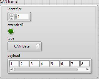

The CAN Frame cluster used within the NI embedded CAN for RIO only provides 4 controls. They are Identifier, Extended?, Type and payload. None of these controls correspond to the DLC field.

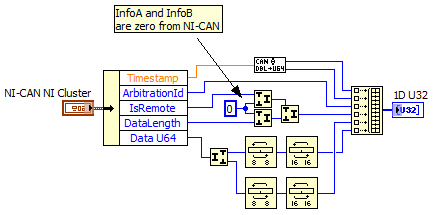

Hi yousif,
I'm working with CAN modules in a cRIO and use the FPGA to exchange CAN messages.
The driver for CAN modules within FPGA provides all fields as needed:
Message 14 of 22
(2,317 Views)
Edit to my last post:
The CAN modules can use an array of 6 U32 values to transmit a CAN message. In the next image you see how the CAN cluster converts to this U32 array:
(The byte ordering stuff is added by me as I use an U64 instead of an U8 array to hold the CAN message data.)
The main point here is the way how IsRemote? and DLC are packed into one U32 value…

I am not using the regular NI-CAN library. I am using the NI embedded CAN for RIO because my board, the sbRIO 9651, is not supported by NI-CAN. The only access to a CAN Frame is through the provided cluster:
I'm guessing you can bundle your payload as an array of three bytes?  (Or however many you actually need.)

Thank You Bill. Your method worked. I just wasn't sure of how to change the array size in the cluster but I figured out that you can delete array elements from the front panel and that would change the array size.
