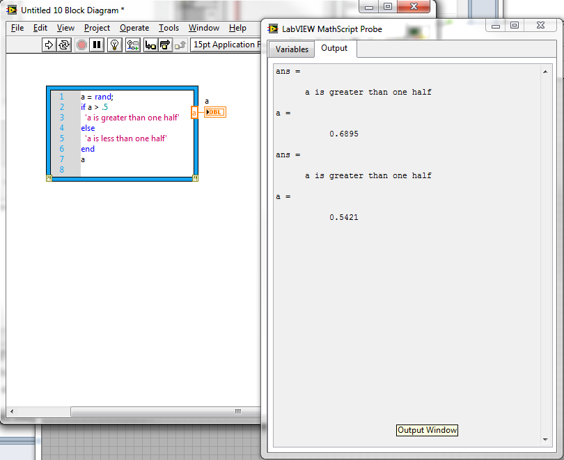

Hi again,
In the MathScript Window, you can do this by typing a command without a semi-colon ( ; ) after it. This will print the result of the command in the output pane of the MathScript Window. So if you want a line of text, you could just type that string and MathScript will print it.
You can do the same thing in your code in the MathScript Node. To see the output there, use the output tab of the MathScript Probe. You launch the probe by right-clicking on the MathScript Node and selecting "Probe" before it runs.
Is this the kind of thing you were looking for?
