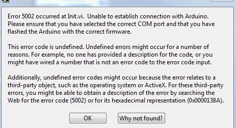

Yes sir, my problem is with the lifa only. for the coding. i try what you told me just now already, and it rotate then an error just pop out, i will attach it with this message. for the example in labview right
when we set speed: i put 100
steps to move: 200 ( because to make a complete turn for my motor is 400)
set acceleration: i put  100 ( in fact how much should we put)
and the last stepper what is this i dont understand...
i thnk my coding for LIFA is nt good u knw i am putting the code in the VISA one
where did u put the coding for the stepper in the LIFA
Message 9 of 20
(8,777 Views)
Error 5002 is  related to the port/baud rate problem,, I also had this error first but when I uploaded the sketch of LIFA_Base it started working.
