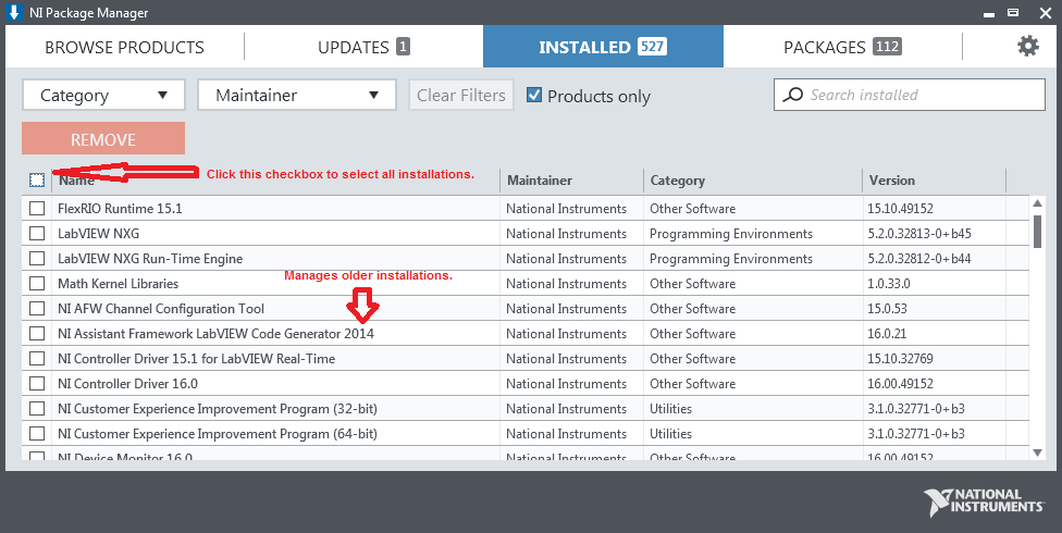

It would make sense to embed this in the NI Package Manager.

Yes, it is new.  But not exactly part of LabVIEW 2017.  NI Package Manager is a lot like VIPM: a separate application that manages the NI installations and eventually any packages we build for it.  It can currently manage the installations of anything previous to LabVIEW 2017.
Just a side note: NIPM is actually more associated with NXG.  But that is beside  the point.

The NI Package Manager, which is the add/remove programs entry for all NI software, can remove all the NI software in one go. The NIPM is installed with all recent NI software. It manages all the installations, even for older NI software.
If none of the NI products you are using installs NI Package Manager, you can download and install it directly.
