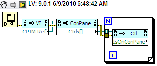

When developing LabVIEW automation tools, I miss a way to list the controls connected to a VI's connector pane. That would make it possible for the user to better select which controls to set before calling a VI (dynamic VI call).
An "IsOnConnector" property on a control reference would be very useful. Or better; a property returning an enum with one of the four values: "NotConnected", "Optional", "Recommended" and "Required".
Another solution could be a property like the Controls property on a Panel reference, but only listing the controls on the connector.

You can get the reference to the connector pane from the VI's reference and use that reference to get the Controls[] property for the conpane. It also has a WiringRules[] property which returns the rules.
Also, the Control class DOES have an Is On Connector Pane property.
Do you have the scripting API installed?

First, the scripting API only exposes the properties in the editor. Code which has them will work fine even if it's not installed.
Second, the classes, properties and methods exposed in the API allow not only editing VIs, but also doing what you requested.
I'm not sure what this has to do with dynamic VI calls, since you can pass values to any controls (not just controls which are in the connector pane) and presumably you need to know which controls you want to pass the values to beforehand.

I don't have access to LV at the moment, but you should have access to the property once you install the API.
The code will work because the API does not ADD anything to LV. It simply exposes classes, properties and methods which already exist, but which have been hidden.
You should note that these properties will not necessarily be available from the ActiveX API which LV exposes (assuming that's what you're using to access the VIs from .NET). If that's the case, you can probably do it by having a VI which will access the data and then call that VI from the .NET code.

Thanks, tst and jcarmody.
I have installed the scripting API, and I can see it contains all that I need.
It will be interesting to see if I can get it working on LabVIEW Real Time.
I still think that the three properties used in jcarmody's snippet easily could be available without the scripting API installed, because they can be useful for other tasks than scripting VI creation.
