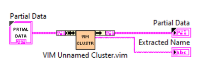

Meanwhile I have found a workaround which will solve my specific use case:
Using an unnamed cluster as 'ears' for the malleable and making a somewhat specialized but still malleable VI.
Thanks again for the discussion and your argumentation.

2021-11-03 11_33_36-VIM.png2021-11-03 11_33_52-UserBlockDiagram.png2021-11-03 11_34_08-UserFrontPanel.png
