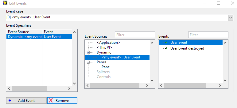

So when it comes to using a queue, there is a somewhat common design pattern used by NI examples, which makes a producer consumer loop, where the consumer uses a dequeue function with a timeout of -1. This means the function will wait forever until an event comes in. But a neat feature of this function is it also returns when the queue reference becomes invalid, which can happen if the queue reference is closed, or if the VI that created that reference stops running.
This idea is to have similar functionality when it comes to user events. I have a common design pattern with a publisher subscriber design where a user event is created and multiple loops register for it. If for some reason the main VI stops, that reference becomes invalid but my other asynchronous loops will continue running. In the past I've added a timeout case, where I check to see if the user event is still valid once every 5 seconds or so, and if it isn't then I go through my shutdown process.
What I am thinking is that there could be another event to register for, which gets generated when that user event which is registered for, becomes invalid so that polling for the validity of the user event isn't necessary.
before:
after:
