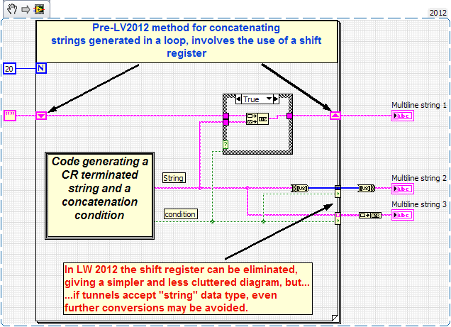

I finally found the time to download a trial version of LV2012. I find that the new 2012 features are really useful and interesting. Good job NI! Smiley Very Happy
One of the greatest for me is definitely the new "concatenating tunnel mode".
I've noticed that it cannot be activated with a variable of scalar type, and this obviously makes sense for almost every type of variables. However, strings are only formally scalar variable. I have lots of VI where the concatenate string vi has exactly the same use (on strings) that Build array has on numerics type of data, particularly when the concatenation had to be conditional. Obviously it is possible to convert the string into a U8 array before to connect the wire to the tunnel, and reconvert it into a string out of the loop, but this convertion probably can be internally managed without too much effort.
The attached snipped can show you what I mean. So, in my opinion, if tunnels could accept strings also when in Concatenating (conditional or not) mode would be great.
Cheers.

Sorry, in my message I've attached the snippet instead of making it visible in the post, but I don't know how to do the trick...

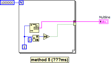

crossrulz
Knight of NI
Hate to do this to you, but I've added another way to do this.  It would be interesting to see which way is truely the most efficient.  I just don't have time to do a benchmark right now.

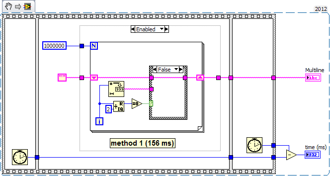

I took the time of a benchmark (only for speed) of the different proposed methods... and the winner is...
1. the use of shift register (not so surprising) Smiley Very Happy
2. the use of two conversions String->U8 array->String and the tunnel conditional concatenation
3. (with a time close to the second method) the use of a TRUE FALSE vi, and the external convertion using the concatenate strings.vi
4. the conditional tunnel for building array, and the external convertion using the concatenate strings.vi
I included the snipped of the vi I used, if you want to check results on your PC.
Ok, good to know. However, I must say that I am not always looking for the maximum speed. Often execution time is not the primary performance to look at. From the point of view of software maintenance, the clarity of the diagram may be very important. Don't you think that it would be great if it were possible to write our example as follow? Neat, isn't it? Smiley Wink

Ironman99
Member
I forgot the snipped...

Your test involves short strings.  Do longer strings with variable length affect your results?  Please post times if possible.  Thanks
Ironman99
Member
Although the tests proposed are very interesting, I think we're going a bit off topic.
The point in the proposed idea is:
since (unlike other variables) it is absolutely legal to concatenate strings together, why LV does not allow us to do that operation, using the new tunnel's features?
If NI has implemented these new features efficiently or not, is another (interesting) topic. Of course, knowing the performance of different methods, you can choose the one that best suits your situation. For those who can not open the attached snippet, I write with pleasure the results of four different methods:
1. the use of shift register (not so surprising)  = 156ms
2. the use of two conversions String->U8 array->String and the tunnel conditional concatenation = 185ms
3. (with a time close to the second method) the use of a TRUE FALSE vi, and the external convertion using the concatenate strings.vi = 207ms
4. the conditional tunnel for building array, and the external convertion using the concatenate strings.vi = 425ms
wevanarsdale:   Obviously these results can vary a lot, case by case. In the example VI, for each iteration, the lenght of the added string is "small" (1 to 6 chars) but the resulting string grows a lot, because of the 1000000 iterations, up to about 3M chars. For each iteration the concatenating tunnel has to manage such a big string. I tryed to increase the lenght of the added string (up to 50 chars), but the the podium positions didnt change. The method that more suffers of the increased added string len is (obviously) the one with str-> U8 convertion. As far this test is significant, the new tunnel concatenating mode seems to work efficiently enough for my purposes.
