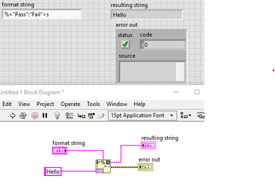

Currently LabVIEW rerturns no error if we have a string connected to the terminal like this:

Pretty much everything between < and > in a format specifier seems to be ignored, except for %<>T, where it is actually used:
I think that helps this cause... It makes this adjustment an extension, without having to change how things work.

The syntax apparently already exists, instead of ignoring the code between angle brackets LabVIEW should use it, the code below should output "Pass".
