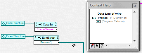

Can you tell me how to get a list of Selector Labels from an Event Structure refnum?  It seems like I should be able to get at it like this (except not Color property), but I'm stumped.
http://lavag.org/uploads/monthly_07_2009/post-7534-124837123385.png
I'd like to expand my CaseSelect RCF plugin to accommodate Event Structures as well as Case Structures.

I need this functionality as well for a new RCF plugin I'm working on.
It seems the array of Refs from the EvntStruct:Frames[] property outputs a somewhat generic "Diagram Refmun" instead of "Frame Refmun" or something like that that I could get a Frame Name from.

There's a discussion on LAVA where I posted a solution that uses OCR to extract this information.
