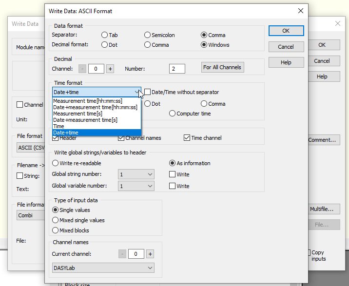

Is it possible to send time of day data as well as other data to a csv file using the write data module. Im lookin to send a string something like below.
12:00:30      2.00       3.35
this example shows the time and the other two columns would just be voltages  etc.
Could this be done using strings or variables to create the string then sending it to the write data module?

In the Options button next to the file format (CSV, ASCII, TEXT), you can select the way the date and time is saved. 2019-06-28-PrintScreen-0000.png

Thanks CJ,
I thought id tried that and it didnt work but it does now!
