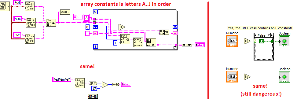

 (found in here. )
Some random code fragments (At the top as implemented and equivalent alternatives below).

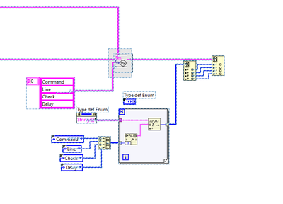

The subVI takes an array of parameter names and outputs a corresponding array of parameter values.
This code will only work if the order of elements in the string array matches the order of the enum constants and they both match the order of items in the enum typedef.  Of course the proper code would be:
I just not sure how I can go about edifying my cow-orkers.
Message 2305 of 2,635
(6,229 Views)
Would this resolve the issue of enum order (and allow for some error handling Paul?)
We were after a Rube solution weren't we? 😜
edit:
Of course it might just be simpler to pass an indexed string output of the FOR loop (Format into string) into the subVI thereby using the Enum and eliminating the Rube!😂
Much more edifying for everyone - use of Enums is good, prevents Typos in Strings and updates when type def gets updated.

@paul_cardinale wrote:
edifying
Nice word I didn't know, btw
Message 2307 of 2,635
(6,157 Views)
edit:
Good Lord!.  Your 1st whack at it is worse than the original crap!  And in your 2nd dump you're building an array from constants instead of just using a constant array!  Did you study under Rube Goldberg?
