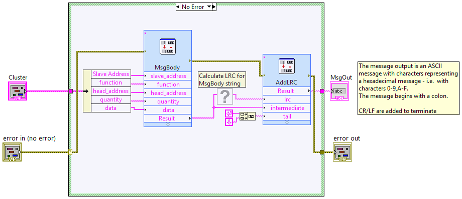

And then in another example - RG version
and new version
I added the FP to show that actually I was previously indexing the entire cluster in order. I don't think I knew about the Cluster to Array node when I first wrote this, so I understand that... but an Express VI instead of Concatenate String, sat right next to a Concatenate String?
