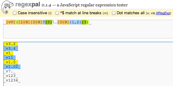

I've just realised that I needed to add some more requirements to the Regex expression that jack answered back here: http://forums.ni.com/t5/BreakPoint/Regular-Expressions-Board/td-p/1187799/page/8
And after hours of trying I've given up, but I know there must be an answer, because you can pretty much do anything with Regex.
Basically I need to make sure that the Version number
a) Matches one or two digits (first must be non-zero).
b) Optionally have a decimal point.
c) Optionally have one or two digits after the decimal point if it is present.
eg. 1, 11, 1.0, 1.00 are all valid version numbers
My Regex expression below works for most situations, but fails on two of them:
a) If I have GN0_v7._xxxx.mtt the version number will pass as "7." which I don't want, it should fail.
b) It will also accept GN0_v123_  or  GN0_v1234 etc. which I can see why in my expression, but goodness knows how to fix it.
Message 93 of 150
(12,025 Views)
And after hours of trying I've given up...
A quick go at it, try this: _[vV]([1-9][0-9]?(?:\.[0-9]{1,2})?)_
The key is the Non-Capturing Group, and also pulling the decimal literal out of the Character Set.
It appears to pass the test cases from your example:
RegexTestCase
PS -- In the future, copy your current Regex and Test Cases into the browser, rather than a screenshot or even a VI Snippet -- this is the easiest way to get support for Regexes 🙂
Message 94 of 150
(12,020 Views)
Thanks Jack, works great - now I know how to use Non-Capturing Groups ie.  ?:

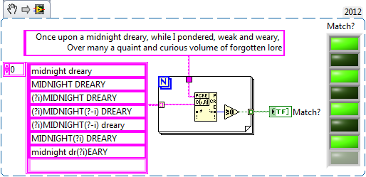

And to continue this topic -- you can toggle Matching Mode directives at any point in the regex. To "turn off" a matching mode directive, use a minus sign (hyphen) before the mode identifier.
Multiple modes may be toggled in one directive group, as illustrated below with some nonsensical regular expressions:
(?is)first(?-i)second
(?ism)first(?x-is) s e c o n d
Typically, these directives are placed at the very beginning in order to apply to the entire regex, but it's sometimes desirable to toggle matching modes at arbitrary locations withing a given regex:
RegexToggleMatchingModeDirective
Input:
Once upon a midnight dreary, while I pondered, weak and weary,
Over many a quaint and curious volume of forgotten lore
Regular Expressions to test:
midnight dreary
MIDNIGHT DREARY
(?i)MIDNIGHT DREARY
(?i)MIDNIGHT(?-i) DREARY
(?i)MIDNIGHT(?-i) dreary
MIDNIGHT(?i) DREARY
midnight dr(?i)EARY
Message 100 of 150
