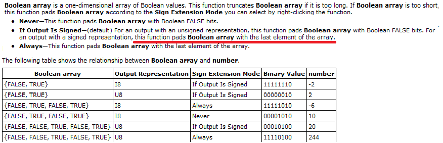

Here's one for the purists that always try to eliminate benign coercion dots.
First the scenario:
In order to avoid the coercion dot at "index array", the output configuration of "boolean array to number" has been changed to I32, nothing else.
I challenge anyone to guess the output value for the following code. You can click on the spoiler later.
(Yes, it would be pure evil to turn that into a CLAD question 😄 )
Spoiler
The issue is that the "sign extension mode" defaults on ON if the output is signed and the index here will be -3 and the element will be zero because that index does not exist. The fix in this case is to change the sign extension mode to "never" and everything will work as expected. See also my post in the Rube Goldberg thread.
It seems to be a serious omission that the sign extension mode is nowhere to be seen on the properties page where it should be featured prominently, not to be missed!
I have posted a relevant idea, please vote for it!

Does it treat those 4 bits as the most significant bits and tack on 28 0's afterward? That would make the index decimal -1610612736 and give the default I32, 0?

No, they are LSB, but will get padded with ones for the missing bits if the last element is TRUE.
from the help
If we add another FALSE the the end of the array, things work just fine, of course:

The last element is False, no?

Yes, if the last element is false, all is well.
If the boolean array size is N, the algorithm basically treats it as signed N-bit integer, i.e. the last boolean is the sign bit. This can probably be useful in limited cases, but I was surprised that sign extension is enabled by default.
(Also teaches you that blindly trying to eliminate coercion dots can have unintended secondary effects.) 😄

Since we are talking about boolean arrays where each element is a bit, first and last elements are well defined in terms of array ordering,
Element zero will the LSb, while the "last" (sic) array element will be the MSb (or the sign). See also.
To be more clear,  we use e.g. LSb, not LSB, because we are talking bits, not bytes. 😄
