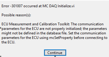

I have a cRIO-9057 with NI9860 Module. With MAX I can read values from the ECU (Bus Monitor).
When  i execute the VI. I have this error in MC DAQ Initialize
Parameters (CRO, DTO,Seedkey ) are not defined in the data base. my question is :
These parameters are mandatory for communication with the ECU (I want just read some channels)??.
I added the parameters (CRO and DTO chosen ramdomly) in the code but I still have the some error.
Are these parameters defined by the Constructor?

I forget the screen error

Hi RchB,
This indicates that NI ECU MC Toolkit is not able to parse your A2L file. You can extract these communication parameters manually use Notepad++. Taking shipping CCPECU.a2l as an example:
For CCP, search for keyword /begin TP_BLOB
Definition of each parameter is provided at the top of the A2L file.

Hello ZY_Ong,
Thank you for the answer.
I use Nodepad++ to extract data but I don't find these information.
I thinks the A2L is not complete ( missing parameters)

Hello Zy_ong,
Now l have an A2L (on XCP) when I extract these  parameters manually using Notepad++ I have ( DTO = 9F79E001, CRo= 9F79E000). when I use A2L Viewer I have (DTO = 1F79E001, CRO= 1F79E000) and in VI Labview (Using ECU MC Toolkit) I have 3F79E000.
Have you any explications ??

The extended CAN ID range is 29 bits, no ID can be a value that requires more than 29 bits to hold it.
https://en.wikipedia.org/wiki/CAN_bus
Since this number has to be held in a U32 sometimes bits at the end can signify flags like if it is an extended ID or not instead of having a separate boolean.  Here is the older NI-CAN which would OR 0x20000000 to any ID that was extended.
In your case an ID of 0x9F79 E001‬ is 0b1001 1111 0111 1001 1110 0000 0000 0001‬. If we truncate this at 29 bits we get 0b11111011110011110000000000001 which is 0x1F79E001.  This likely is the real ID you would see on the bus, but extended of course, because it uses more bits than the standard ID can.
