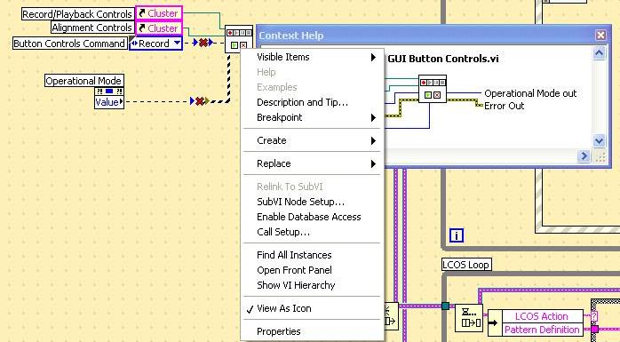

Maybe related, maybe not, but why do I sometimes get a handful of connector highlighted on my VI icon:
It might be a graphic adapter driver issue (I have had a number of redraw issues with LV over the years with all kinds of computers and I am ignoring them by now), but maybe not. I hover over the VI with the wiring tool and the selection "ink spot" is not arased as I moved to another one.

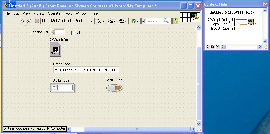

New example: I created a VI from a sequence structure and added a few controls on the FP, so I decided that instead of switching connections, I was better off disconnecting them all and starting from scratch. Here is the result:
I have really a hard time understanding why NI doesn't seem to be able to reproduce this problem...
