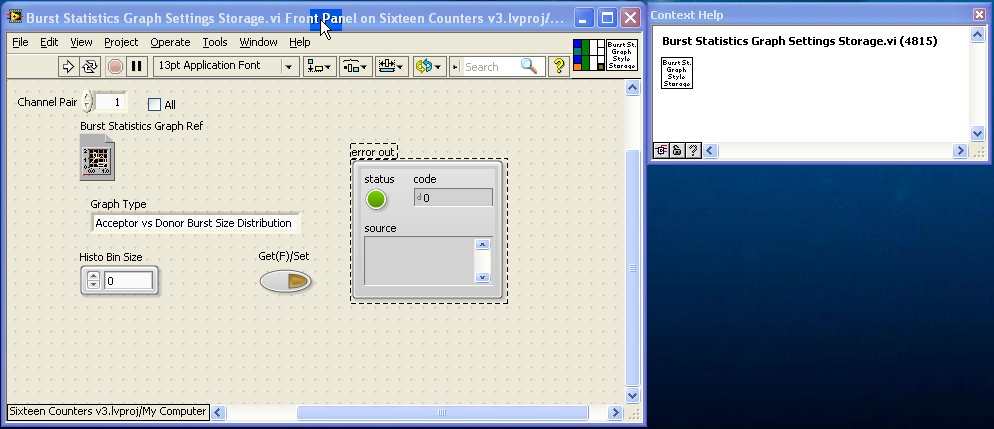

What do you think about this one:
It is LV 2011, but where did the icon go? Smiley Very Happy
Actually, as a matter of fact, it appears that this is not the only VI to experience this interesting mutation:
Smiley Very HappySmiley Very Happy
