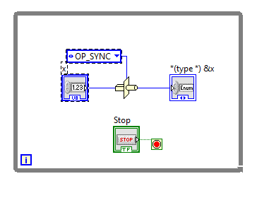

But i am not sending Op Code greater than 2.
0 - OP_SYNC
1 - OP_LED
2 - OP_SENSOR
3 - OP_FUTURE
I separate out that section in new VI even then for 0 type casting is correct but when i change that to input to 1 i get output as OP_FUTURE

I am attaching the VI also.

Change the representation of your enum to a U8.  It defaults to a U16.
The reason this is happening is that LabVIEW uses Big Endian.  Therefore the single byte you supply is used as the most significant byte and the lower byte is filled in with 0.  So your 1 is really 256 after casting to a U16, which is way above the range of the enum.  Therefore you get the last item in the enum.
Right Click on Enum Constant and then clicked on Edit Items and then change to U8
Thanks alot for the explaination, this makes me clear why that was happening.
