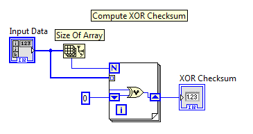

Hey Thanks for your reply.
I did it, created a separate SUB VI to calculate the XOR Checksum.
Is it okay, please suggest if you find something worng in this.
Now i will use this Sub VI in my main project.

That will work.
But you don't need array size or to wire it to the N.  With auto-indexing the For Loop will automatically the number of times for the number of elements in the array.
Thanks for again pointing this thing.
I removed that array size block and it works perfectly.
