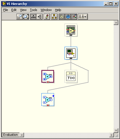

If you have a polymorphic VI in your VI hierarchy, when you view the hierarchy, it seems like every single polymorphic instance of that VI shows up, as well.  This doesn't help me at all, and I don't know why it works this way.  I should only see the specific VI's I am using.
After dropping just one function (DAQmx Read [Analog DBL 1Chan 1Samp])
Now check out my VI hierarchy!
It's gone berserk!  It is showing me every single flavor of DAQmx Read!  Try this for your own amusement. Smiley Wink
Why don't I see only one DAQmx Read function in this hierarchy?  Or maybe someone can shed some light on why it SHOULD work this way.  I definitely think it SHOULDN'T.  The block diagram I posted above should not have a hierarchy like this!

Well, I had been frustrated about this for a long time. However, each time I choose to "Hide All SubVIs" for poly (of course, for each one of them - another button in toolbar will be great).
Perhaps Aristos could explain us why FFT does not have "uncalled VI"?

In that case, could we at least get an additional filtering button so that we can temporarily hide the unused VIs - thus, allowing us to actually see the VIs we're interested in?
Ben
Knight of NI Knight of NI
Knight of NI
I'd like a button taht allows my exclude the un-used version of the PolyVI like I can shu-off VIs in VI.lib. I use this button regularly to shut-down all of that noise.
