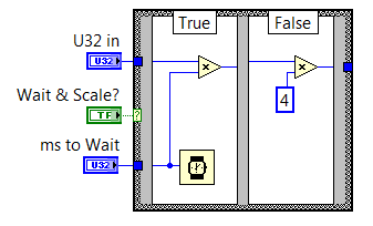

I find it takes a lot of clicking to examine LabVIEW code to understand what the code actually does.  One such place that code is hidden is within a case structure.
Particularly for simple case structures, with only true/false conditions, it would be great to show both cases of the case structure on the diagram at the same time.  This would help avoid users clicking through cases to review code, and would certainly help make printed-on-paper LV diagrams more useful.
Here's an example of such a case structure:
as opposed to the current behavior, where either the True or the False case is shown at a given time.
Note: I'm presuming LabVIEW's editor wouldn't allow the user to edit in the 'gray area' in the mockup above, and there are surely some details to work out in terms of how wiring those tunnels would work.  But this would be cool to make a reality!

I don't like the wires that point nowhere. Imagine you have 20 cases!
For complicates structures with many connectors, it would be a mess, and for very simple cases you don't need to use a case structure. Simply wire both scenarios in parallel and and use a select primitive, for example.

This is something I really want for a long time. I never came up with a nice way of doing it. The way the idea of seeing multiple cases at once is no good, agree with altenbach.
How about using something alike Windows Aero? I think this should be only for visualization, not for editing.

For simple True/False logic one could use the select primitive (9-26-2011 9-48-01 AM.png). This has the advantage that everything is visible. Of course this might result in extra data copy and a potentially slower performance (since both case are evaluated). In most situations I found that the improved maintainability is well worth the performance penalty.
Note: using the select primitive will not work in the post example since the wait is conditional.
