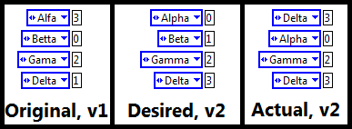

But what if you mutate one of the enums, by adding items, removing items, rearranging items, or renaming items? Now you're in a pickle, because Enums currently do not store mutation history as part of their definition.
Consider the simple enum, GreekLetters, as part of a project developed by So-So Engineering, Inc. The SSEI developers launch the code into production with version 1 of the enum: v1: { Alfa, Betta, Hero, Delta } (The So-So engineers aren't too good at Greek, but so-so engineering brings home the bacon at SSEI).
