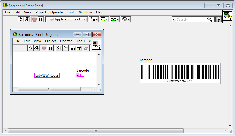

The IMAQ VIs are great for recognizing barcodes that are scanned.
On the flip side, there's not a really portable way to generate a barcode in LabVIEW (without having to install a barcode font). The nicest approach would be to have a custom control that has string datatype, and then on the front panel, the string gets displayed as a barcode!
Other approaches could involve using a picture control or something as well.
Simple numeric barcodes are possible with fonts, but most barcodes
require calculating a checksum and/or start-stop characters. 2D barcodes are a different matter and wouldn't work as a font.
If using TestStand, you could use various barcode software packages that include an API to create an image (in memory or as a file) and place this in the report.
I'm actually working on this as a side project. I'm implementing UPC, EAN-13, and Code 39 (AKA 3 of 9). Do you have any other suggestions? I was thinking Code 128. Currently my framework only works for 1D barcodes, but I could conceivably expand it for 2D barcodes (QR, DataMatrix).
