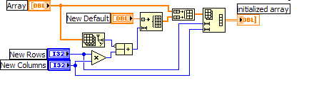

For this particular case (1D to 2D reshape) I have used the following to add NaN

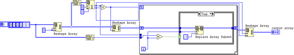

Here's what I probably would do....
I agree, a terminal to define the default pad value would be nice. I would prefer the connector on top, though.

Altenbach's Proverbial Postage Stamp Block Diagram strikes again.
Here's where the Chameleon/Shapeshift/Type-Adapting VI capability would come in handy (even though, you would have to write a new VI for each output dimensionality).
