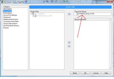

For the moment, when you want to create a Packed Library you have first to create a LVLIB. Smiley Sad
The PackedLibrary build specification is based on a LVLIB ...

I recently encountered a niche situation where I desired the ability to build an auto-populating folder of VIs into a PPL.
As noted here, packed library build specifications require a top-level library declaration.
However, I found that a workaround is possible.
I was able to create an empty lvlib as the top level library.
Then I added the auto-populating folder of VIs as "always-include"
These VIs are not visible if you open the LVLIBP file in the LabVIEW IDE.
But the VIs are still compiled into the LVLIBP.
And I find that I'm still able to access/launch them by opening VI ref by path, and then running VI be ref.
This met my needs.
