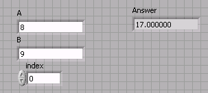

On the top level VI, named Test.vi, you can 'add' A and B.
The index will tell the VI whether to treat A and B as an instance of the 'data' class or an instance of the 'strings' class.
Both classes are clusters of 3 controls : A, B, and Answer
For example, if you enter A = 8 and B = 9:
If you set the index to 0, both A and B will be treated as numbers.

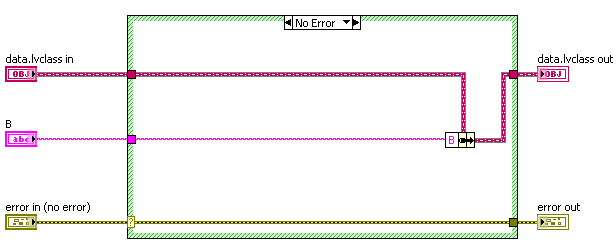

Write B:

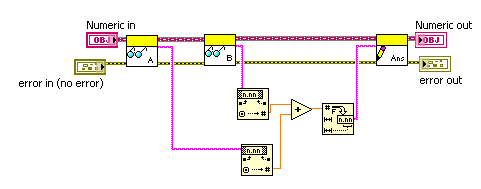

If it determines that A and B are numbers (instances of 'data') it will add the two values:

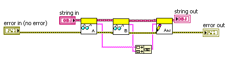

If it determines that A and B are instances of the class 'strings' it will concatenate:
In both cases, the returned value is passed to the control 'answer'.

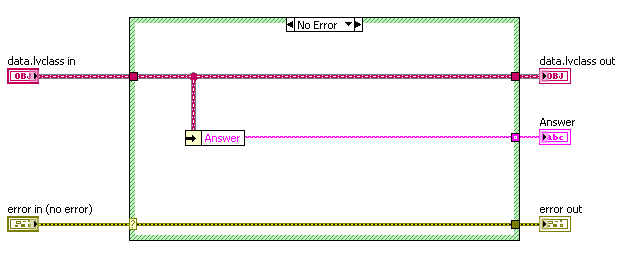

This answer is read by 'Read Answer.vi':
The user then sees the final answer of the whole operation.
