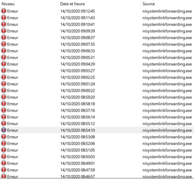

We're also having the following problem:
(3,585 Views)
for the hearbeat problems we can have the following Windows events. Nothing can happened for a long time and suddendly it's like that:
for the first message written by sklod, we saw that we had a message with a timestamp from July that was still send in october! and as far as we had a look, it was send each minute!
Apparently the new client 2020R3 (previously 19.6) solved this problem
We still have sometimes the message but with a recent timestamp and it disappears after (should be a "normal" error). Now we have a lot of heartbeat messages

As I mentioned in the reply to sklod above, the issue relating to the Test Monitor API has indeed been improved in client versions after 19.6.
However, the message that you still see leftover is instead related to the Asset module. It's trying to publish Asset Utilization data, but it is unable to see the APM service. This isn't really an error case for the forwarding service, as it will simply retry until the APM service becomes available, but we can definitely reduce the log spam when this happens.

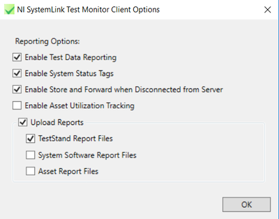

For the second part yes we have the asset manager module installed but we do not have the licence for it:
and for what you say well, we saw that sometimes after a server reboot than not all the services were started on the server. We don't know if it concerned the APM service but we can have a look next week on that. Since we had this problem of services two times, they might be a correlation but we have to check.
Could it also be linked to the teststand configuration for SL (Enable asset utilization tracking)?

Glad to hear that the test results made it through.
The errors are not necessarily linked to the Asset Utilization Tracking in TestStand. All the Asset Utilization information from all sources goes through that forwarding service. Even if Asset Utilization Tracking is disabled in TestStand, there could be something else on the system publishing utilization data.
Also, it won't stop giving the warning until it manages to successfully publish all the leftover utilization data on the system. Even if whatever is creating the data is stopped, the existing data will still be there on the target, waiting to be synchronized with the server.
nisystemlinkforwarding.exe will continually log this error as long as it has APM data that it wants to forward, but can't for some reason. According to the error message above it looks like you're getting a 503 from the NI Web Server when contacting APM, which seems to indicate that the APM service is not running or not installed. If there was some recent downtime, then this might be correlated. Still, the APM service being down is not necessarily an error condition for the forwarding service, since it continually retries every minute or so (hence the error message reappearing every minute).
