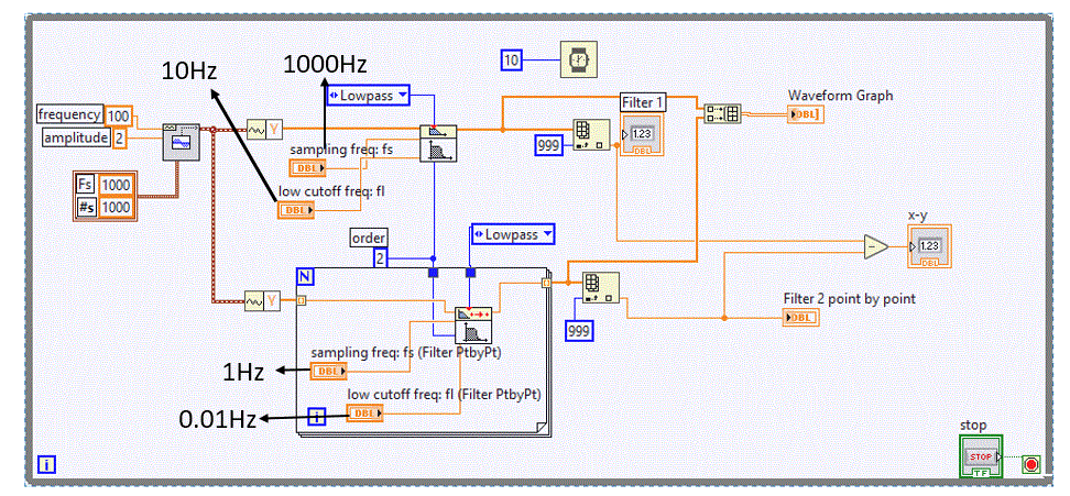

I want to compare a Butterworth filter (normal mode) and a Butterworth filter (Point by point mode) as low pass filters.
I am wondering about choosing the sampling rate (fs) and the cutoff frequency (fc) of the Butterworth filter (one is normal and the other is a point by point mode). The figure is shown below.
For the normal filter, I choose fs = 1000Hz, fc = 10Hz.
For the PtbyPt filter, I choose fs = 1Hz and fc = 0.01Hz. Here I consider one point of the input of the filter will create one point of the output of the filter. So the fs of the filter must be one calculation per loop at the time T= 1/sampling rate of the input signal (the filter is in the FOR LOOP).
--> It means that the sampling rate of the Butterworth filter is 1Hz at each the time T = 1/1000Hz (1000Hz = sampling rate of the input signal). Of course, for 1Hz of sampling frequency of the filter I choose fc = 0.01(Hz). It corresponds fc/fs = 0.01/1 = 10/1000.
I referenced Mr Henrik's programThe simulation results in two cases are the same.
So, fc = 0.01(Hz) and fs = 1Hz for the PtbyPt filter at the time T = 1/1000Hz are correct in principle, aren't they?
Thank you.
