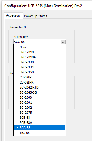

Why SCC-68 board is dropped out from the newest DAQmx? It would be nice to use it together with SCC-TC01 thermocouple modules. Is there anyway to get this working with M- series USB DAC cards like USB-6255 with NI MAX 20.70?

Looks like SCC-68 is supported for Connector 0 only and not on Connector 1 (this is on DAQmx20.0)
Please connect SCC-68 to connector 0 and select the same in configuration.
I believe, nothing is limiting you from using SCC-TC01 with SCC-68 (once you have connected it to Con0)

I am now testing the SCC-68 card and SCC-TC01 module with USB-6255.
Unfornately the temperature measurement is not working with this combination. But the same sensor is OK with NI USB-TC01 device. We have similar experiences also before, that the SCC-TC0X temperature modules do not work with the current DAQmx and USB data acquisition cards.
I use DAQmx 20.70. Do you know, if there is any hope to measure temperatures with SCC-TC01 module and for example USB-6255 device? The analog input works in SCC-68 and can measure voltages directly.
The SCC-68 card is possible to select in MAX but its configuration is disabled. Cannot make any changes:

have you tried with a older DAQmx version, perhaps 16.0 or earlier?

Hi Santhosh,
Yes, I tested with many different DAQmx versions. I do not bremember exactly about the results.. but not so good. And anyway I use always the latest DAQmx.
BR, Ilkka
