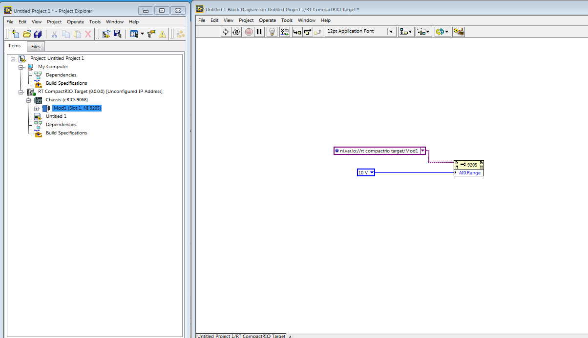

is there a way to set the input range of a channel on my NI 9205 with LabView using the scan interface (i.e. not FPGA interface)?

I just setup a quick project and looks like property is there. Is this what you looking for?
I'm only setting one channel but you can set all of them.

Yes, that's exactly what I was looking for. I just confirmed that it's working and is correctly changing the  voltage range at runtime. Thanks!
Detailed steps to get to what's in  Miro_T's screenshot:
  • In your LabVIEW Real-Time Project expand your chassis
  • Drag and drop the module for which you want to change channel settings into your .vi (this creates a refnum)
  • Rigth click this refnum and choose "Create"
  • You can now select a property / method for which to create a property / invoke node.
  • If you selected a voltage like in the example above you can then right click on the unconnected terminal and choose "Create -> Constant" to get a selection of the valid values.
