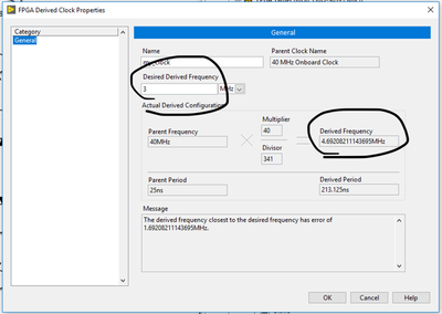

My goal is to run FPGA code using Single Cycle Timed Loop using 3MHz or less frequency. The problem I am facing now is cRIO-9039's FPGA Target appears not supporting deriving the clock to less than 5MHz (1/8 derive rate of 40MHz).
Are you getting an error? Or is it just not letting you type in a value less than 5MHz?

It lets me type the frequency but the adjusted (closest to requested) frequency is much higher.
For example, if I type 3MHz, it's only possible to make 4.69MHz. If I type 10Hz, still 4.69MHz.

I tried it on my side and 4.69MHz seems to be the lower limit.
I know you mentioned that you were seeing 3.3MHz in the compile results. Could you post a screenshot of this?
So it is the limit. That is all I wanted to know. Is this documented somewhere?

This specification has to do with the VCO operating range of the Xilinx Kintex-7 7K325T FPGA in the 9039. The datasheet for Kintex-7 FPGAs is found here.
