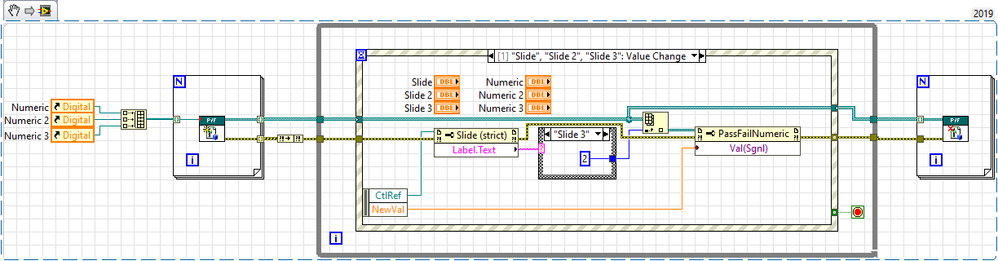

Here is an example of using an array of QControls.  However, I did use Value (Signaling) to cause the event to occur.
An alternative is to override the Value property with your own VI that causes the color formatting.  I think value signaling is the right way to go here.
