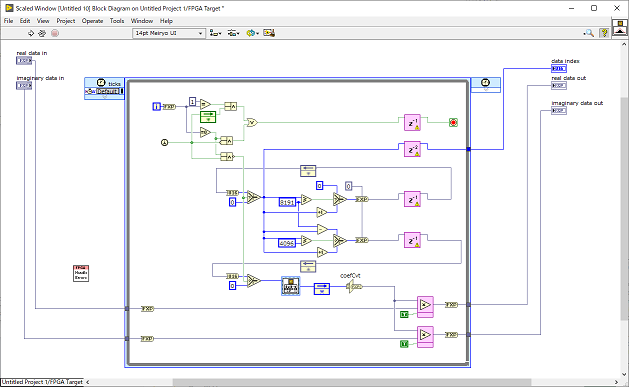

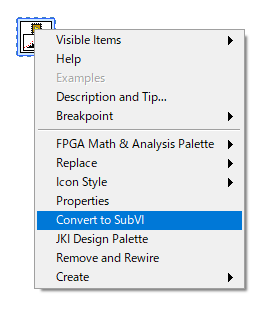

Any Express VI can be converted to a SubVI and Block Diagram can be observed to know the functionality.
Since 5783 handles single sample per clock cycle at 100MHz, this VI may be reusable.  It simply does store window data at compile by using "Configure Look-Up Table 1D", which is another ExpressVI you may also can convert it to SubVI.
If window coefficients are desired to be variable with same bitfile, "NI 5783 - Getting Started (FPGA).vi" Example VI is helpful.  The example shows how to use BlockRAM as a circular buffer.  This implementation can be reused to generate same window coefficients repeatedly.
