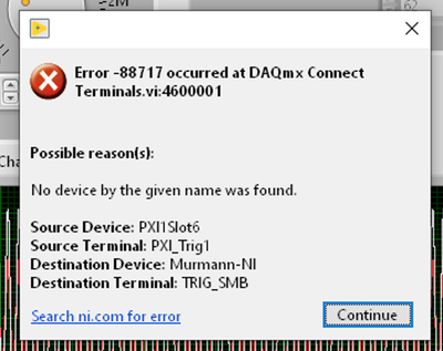

I am trying to use the external SMB trigger on my PXI controller as illustrated in:
https://knowledge.ni.com/KnowledgeArticleDetails?id=kA00Z0000019Uu6SAE
But I don't see my controller listed in the dropdown menu for available devices.
I checked the support for both my chassis as well as the controller with PXI Platform Services version and they show as compatible. It shows up fine in NI Max so I don't know what the problem is.
Is there a way to "refresh" the list of devices that LabView thinks are available?
Help!

I tried this but I get an error: "No device by the given name was found"

Can you send in the code your using or a screen shot of the block diagram where the connection is being made? Also, can you send in a MAX Tech report? I'd like to look at how the connection is being made in LabVIEW as well as the naming and hardware of the devices being used.
(1,853 Views)
I am attaching the MAX tech report as well as a screenshot of the way the connection in made in the VI in question. The source code is also included in the zip file for the MAX report.
(1,846 Views)
Accepted by topic author danzilla
I was able to connect with NI support and got a resolution to my issue. Somehow the MAX configuration database got out of whack. I was able to see all the devices in the system after a configuration reset.
