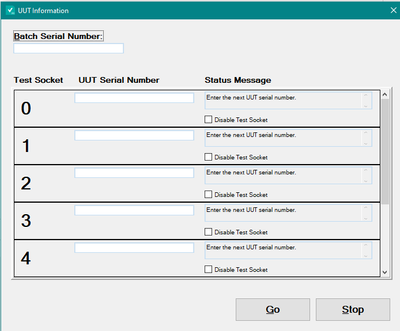

We just started converting some testers over to Windows 10 and noticed that the UUT Dialog changes when running in Windows 10.  As you can see in the pictures, it no longer displays all 8 sockets.  In Windows 10 you must grab the mouse and scroll down to to see the bottom 3 sockets, (whereas Windows 7 displays all 8 sockets without scrolling).  It is also impossible to resize the inner box in Windows 10.  The entire dialog will resize, but the display of the sockets remains the same size.
I am hoping that someone can tell me what settings I can change to allow all 8 sockets to be displayed as they were under Windows 7.

Hi, I checked on my side too. What you are seeing is expected. Looking the screenshot, it is customized UUT dialog box. If you are the developer, you can customize this dialog box to display all 8 at once. I hope this helps.

HI, I am attaching 2019 (left), 2020 (right) TS UUT dialog-box here for your reference. If you observe carefully, the shipping ones does not have Ok & Stop buttons hence I believe is a customized dialog-box.

Thank you.  This is very clearly different than mine.  BTW, mine is the parallel dialog.  Is this also?

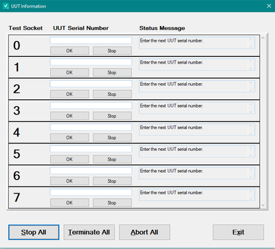

Oh Sorry. I am using Batch process model. For parallel, it looks same as it is expected behavior.
However, I customized it for you to display all 8 at once. I am attaching same with this post. You will have to replace the dll called modelsupport2.dll in the following directory:
  • If you are using 64 bit TestStand C:\Users\Public\Documents\National Instruments\TestStand 2020 (64-bit)\Components\Models\TestStandModels\modelsupport2\modelsupport2.dll
  • (let me know if you are using 32 bit TestStand) i will share it in my next post.
I hope this helps.

Hi, Please find a copy of 32 bit dll. I was referring to this NI KB - https://knowledge.ni.com/KnowledgeArticleDetails?id=kA03q000000YHmUCAW&l=en-IN
Since I had LabWindows CVI installed on my system, I could test the same at my end before sharing it with you 🙂
Do let me know if it working for you or not.

Accepted by topic author OmnitracsTestStand
Hi, looks like many dependencies are missing (it will take time to debug and fix). My suggestion is to customize the source code by using NI LabWindows CVI. You can uninstall it after customizing it.
  1. Navigate to the TestStandModels directory in the TestStand public directory. If you haven't already, you will need to copy the TestStandModels folder from <TestStand>\Components\NI\Models\TestStandModels\ to <TestStand Public>\Components\Models\.
  2. Open the modelsupport2.prj LabWindows/CVI project.
You just need to open the project modelsupport2.prj >> paralleluutdlg.c >> update MAX_NUM_TEST_SOCKETS_VISIBLE 8 (as shown below) >> Rebuild the project by running the project.
