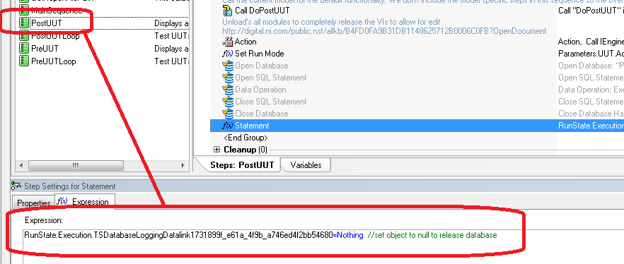

I am trying to get this to work. In my scenario we need to call a external process that will connect to local database on test station and extract some data. This requires the local Access database connection to be closed. I have tried your suggestion (see screenshot below).
Should I expect to see the .laccdb file disappear after this step runs? Any timing that needs to be observed?   Of course I'm asking because simply calling the statement as shown does not close the Access database connection.

I have not worked with Access in quite a while. I do remember that the deletion of the .laccdb file was an indication of the closing of the connection, but I do not know what else might come into play. I do not know of any way to truly determine when the database no longer has a process with write access, other than retry. This is a limitation of Access database. My only recommendation would be to see if you can move to a local SQL Server database instead, which has options for multiple writers and readers.
