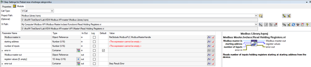

I have Modbus Library.lvproj downloaded from :
http://www.ni.com/example/29756/en/
When I use Labview developement system for Labview Adapter configuration, I can call VIs with no problem:
But when I select Labview run time engine for Labview Adapter configuration it says:
I tried to mass compile Modbus project but it doesn't help. What can I try??

Are you using TS 2019? If so, can you update to TS 2019 f2. We fixed a bug that might give you a better error message.
It is very likely that the VI is missing some dependencies.

Does the bitness of your vi match the bitness of teststand?

In my case I use NI Modbus Library and  I have also the same error code which is generated from time to time in my sequence.
All my functions are compiled in a LvLibp, and if I retry directly the step works fine.

Is it possible to post an example code lvlibp that shows the issue with TS 2019 f2? If you prefer, you can message me directly and we can work out an approach to get the files.

Hi
Is there already a solution here? I am currently facing the same problem.
As soon as I connect a module of the NI MODBUS in Teststand, the reference error occurs under the runtime of Labview.
