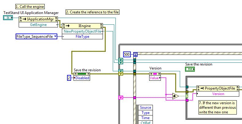

I've got problems with instantiating TS Engine from C#.
What I want to do is a simple C# console application which returns into the console sequence file version number. Basically, I want to write inC# what inLV looks like this.
But I cannot instantiate the Engine by doing: EngineClass Eng = new EngineClass();
Wnat shall I do?

If you look into the example user interfaces, you will see how the engine is retrieved:
First you will need the correct using:
// TestStand User Interface Controls
using NationalInstruments.TestStand.Interop.UI;
and afterward, just call the GetEngine routine and perform what you need to do
NationalInstruments.TestStand.Interop.UI.Ax.AxApplicationMgr.GetEngine().whatever

Yes, I've seen this.
But would it work with Console Application Project?
UI is designed to work with WPF (Windows Presentation Foundation), but I want only the console app.
