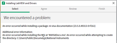

I'm also having the problem.  I suspect it's a hard coded path to C:\Users\Public\Documents\National Instruments in the installers.   Those of us using onedrive have a modified filesystem and C:\users isn't the location for the profiles anymore.  Therefore, the installer can't write to that path.
At least, I think that's what's going on.  I'm not going to test it by removing onedrive as I don't want to re-sync 800GB of data just to test it.
I might try installing in a vm with repackager running so I can install it on my main pc (assuming the vm install works).   Long way to go to get a piece of software working...

I started with an older NI package manger.   I was trying to update to the current release with LabVIEW and Drivers (with ni-scope and ni-dmm).  I say started with because I've reinstalled package manger a couple times now trying different options.
Currently I'm trying to use Package manager 2023 Q2 and Labview 2023 Q1
I attached a screenshot of the error.  I can't seem to upload a zip so here's a dropbox link to %appdata%\Local\National Instruments https://www.dropbox.com/s/mg69oxp07jaujrd/National_Instruments.zip
Doesn't look like much there but there are some MSI logs in %temp% which only contain:
Error 1317. An error occurred while attempting to create the directory: C:\Users\Public\Documents\National Instruments
=== Logging stopped: 4/28/2023 16:22:39 ===
I'll try generating some additional debug info for you later in the weekend.
Message 14 of 33
(12,936 Views)

So what is the error that you are seeing, is it the same as the image post from Kelemvor4 on 4/29/2023?  Assuming the same error, does the C:\Users\Public\Documents\National Instruments folder already exist? Does the NI-DAQ subfolder exist?
Looking more at this issue, if the read-only state is a check in the checkbox then that might be the issue. If the read-only state is a filled-in checkbox, then that is likely not the issue.
I would be curious if your system has controlled folder access enabled, see below for image of Windows setting:
If I enable this setting, I was able to reproduce a similar error as shown below:

Hi, seems to be common issue with corporate windows 11, where installer does not have access to public folder. I also cant install NI drivers. Any idea how to fix please?

Stanislav, can you look to see if the above mentioned Controlled Access Folder option is visible to you, and if the setting is enabled, can you disable it? If it is enabled by default and/or the setting cannot be changed, then there is likely an IT policy being applied.
You can use the following command in a PowerShell prompt to get the value:
Get-MpPreference | Select EnableControlledFolderAccess
and the following in an administrative PowerShell prompt to set the value:
Set-MpPreference -EnableControlledFolderAccess 0
For more information on the setting, see Enable controlled folder access.

Hi Scott,
I also have this issue when tying to install Ni-VISA (also tried installing and have the same issues with permission). The Controlled Access Folder option is visible but not editable on my machine, when I run the powershell command it returns a value of 2. I am unable to edit the value, is this the source of the permissions issue?
Valerie
